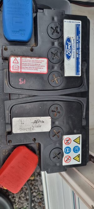

My "leisure" battery is a ford silver calcium 60ah 590a, i believe it's a "starter" battery. side note: the access screws on top were loosened so this has clearly been opened before.

isn't this a maintanence free bat? why were the lugs undone?
considering i have no idea on the age of the battery, is it likely that even if it is a good leisure battery, it may need replacing?

The Ford battery is designed for automotive use, and information from battery suppliers suggest it has different charging needs compared to that of a caravan system. This could mean the built in charger in your caravan cannot properly recharge the Ford battery, and that might be why its not powering the caravan properly.

If you need to go OFF Grid, then you definitely should be using a proper leisure battery. A car type battery does not like deep slow discharges, and that might have damaged your Ford battery.
Most caravans can accept a 110Ah size of battery, and with frugal use of power it should last 4 to 5 days without a problem, But at the end of being off grid the battery may not have enough current capacity to operate the caravan mover.

The difference between car batteries and leisure batteries, is that car batteries are designed to deliver high short bursts of power; to crank an engine over, so there is a high discharge and then when the engine fires its gets charged. A leisure battery needs to deliver a constant voltage at lower current draw for longer periods between charge.
You wont damage a car battery in a caravan, it will charge fine, but just won't have the capacity for longer periods off grid. In fact if you never go off grid and just use the movers, it would suite a car battery just fine.
Neither should be left in a state of discharge for any length of time.

....as a coincidence I have exactly the same battery as the OP.
Ford silver calcium 60 ah.....it is 2009 vintage taken off my 1.4 diesel in 2019 simply because it was10 years old but having no issues.
Since then I have used it as an off grid extra battery.
Still works well at 14 years old and is never allowed to drop below 12.2 volts.
