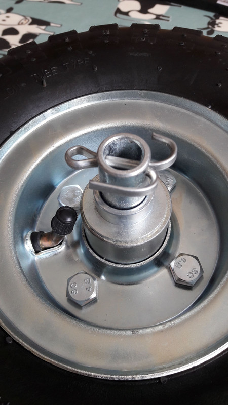

Hi, Does anyone have the Maypole MP4375 jockey wheel fitted and close to hand? It's the one with the pneumatic tyre and the metal rather than plastic wheel.
I have recently fitted one to mine but it does not retract fully into the a-frame as it's a tad too wide at the wheel mounts. Sits a bit low so may well cloud speed humps or give problems in dips. I was going to replace one or both of the axle split-pins with a linch-pin so I could simply and quickly remove and refit the wheel while leaving everything else in place.
However, my caravan is an hour round-trip away and I do not have the measurements of the axle. Nothing useful on maypole's website either. If you are close to this sort of Jockey wheel and a dab-hand with a tape-measure, can you please tell me as much of the following as possible...
1. External diameter of axle
2. Diameter of splitpin hole .appreciate this may be a bit trickier. But is it about the same as a bic insert, twice that size? just a rough idea as I can adjust this a little if required.
3. How much axle sticks out beyond the splitpin hole.
Assuming I get it sorted successfully I'll post up some pictures and a link to the necessary bits and pieces in case anyone else wants to do the same.

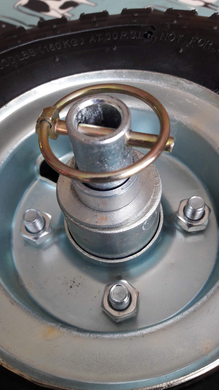

If anyone else is looking to do this, I went over and measured up.
Axle diameter - 19.1mm
Split pin hole diameter - 5mm
Distance from split pin hole centre to end of axle - 6.2mm
As a result a 5mm linch-pin should do the job (5mm nominal is actually 4.5mm so bit of wiggle room). I've just ordered these ones from ebay.

Linch-pins turned up today. Pin is spot-on for diameter. Length and ring diameter are a little more than ideal but I can't find anything smaller and they do latch firmly so should do the job nicely. If you go for it yourself, the rings only spring shut in one direction so make sure you get a positive latch before walking away from it.
Before :-
After :-
