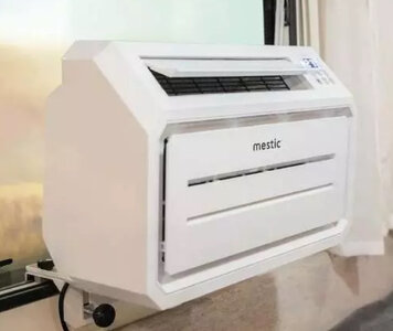

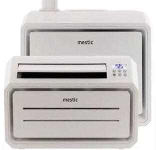

Does anyone have any experience of these units?
MESTIC SPA-3000 SPLIT-UNIT AIR CONDITIONER​
I would not expect miracles, just a little cooling, but not too much vibration or noise.

In theory at least, a split AC unit has the opportunity to provide a better thermal efficiency. The technical specifications for the SPA-3000 on the website tell us it consumes 1.76A (404W) and can produce 895W of cooling performance. That's a CoP of just 2.2 which is actually slightly disappointing for a split system, but better than nothing. It wont have the ice cold blast you might experience from an AC in a car.
Because half the product is physically mounted outside it should be quieter inside the caravan than an equivalent combi unit. Ideally from the caravanners perspective the Compressor should be in the external part to decouple it from the habitation space, but that choice is down to the designer.
According to the advertised figures the unit has a noise level of 53dB, which is the equivalent to a quiet conversation, or the noise of an office. I guess this relates to the noise level inside the caravan, But there's no figure quoted for the external unit, which might be an annoyance to neighbours.
Incidentally, with a little ingenuity regarding mounting, I suspect the unit could be adapted to work at home through a window opening. It might be enough for a single room in hot weather.

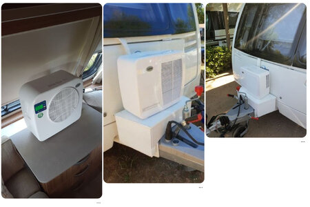

Thanks both. Very useful. Prof, I did think it could be used at home. Mr P. I have seen a picture where the Cool my Camper outside unit was mounted on the ‘A’ frame. But that might have had a longer umbilical.
That Lunar has a custom-made "step" on the A-frame to lift the unit within reach of the window.

Roger is correct re the custom ledge. I did contemplate something similart but I thought where to store it when not required would be an issue, but that would ideal if on a seasonal pitch.

The ‘A’ frame stand is a simple enough thing. It is seasonal caravanning we are thinking of. I also think that the location of the inner unit pointing down the van might be slightly more effective. And less intrusive on the sitting area.

The Mestic unit seems similar in output size and weight to the Cool my camper. But considerably cheaper for a new unit. I do not know about the durability.
Some don’t, it depends on the length of the umbilical. It also depends on the angle of the caravan front. And, of course it restricts access to the front locker.
On the Alicanto we may get, the front is quite vertical and there is no locker. Horses for courses.
