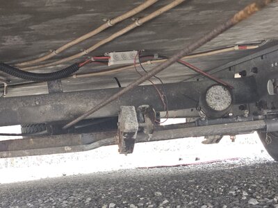

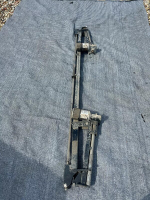

Hello,
I'm new to the whole caravan world and seems there's a lot to learn.
I purchased a caravan which has a motor mover but didn't have the remote, I have sourced a remote but can't get it to engage because there is something underneath that spins, I presume its should be clamped. Any ideas if I can get a clamp? Or any other advice welcome. Also looking the bar is bent, should this be straight?
Thanks

I have sourced the remote and paired and the mover works. However the part in the picture in the middle of the bar spins when trying to engage with the wheels so it doesn't move.

No, I have tried but as you can see in the video, they whole unit spins. So I am assuming that there must have been a clamp that holds it in place so just the bar should spin.

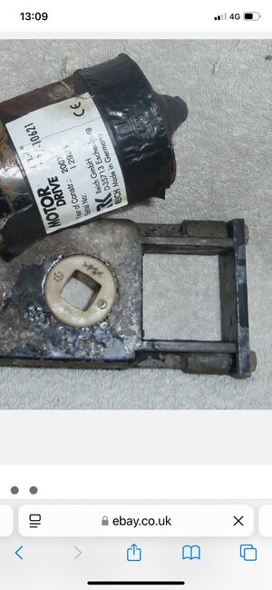

This is the bracket I need. Anyone know where I can get one please?
Thanks

I think It’s a drop plate, so if a side skirt or something is in the way it allows the mover to be fitted slightly lower so the mover missis it
