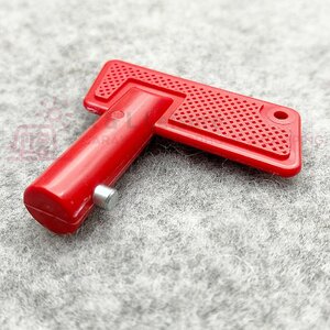

The motor moving works off the battery, and if like mine the key can only be inserted when the mains is unplugged It should look like this 1687295484180.jpeg and rotates about 180 degrees in the socket (in the battery/mains input locker) to activate the mover. The mover handset will likely have a PP9 battery or similar.

Yep switched the motor mover on with the red key in the battery compartment.

The motor moving works off the battery, and if like mine the key can only be inserted when the mains is unplugged It should look like this View attachment 4938 and rotates about 180 degrees in the socket (in the battery/mains input locker) to activate the mover. The mover handset will likely have a PP9 battery or similar.
