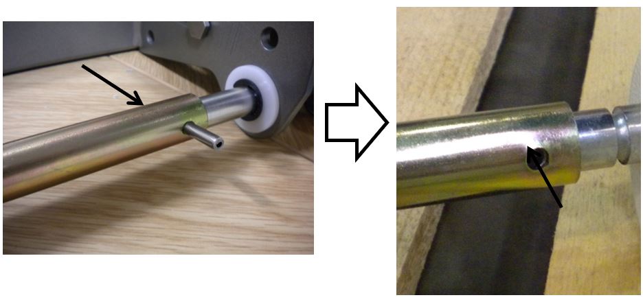

I found that on my power touch it was not the spindles that were twisting, it was the very small 1/8th inch roll pins. I punched them out and drilled the spindle and shaft to accept a 3/16th roll pin . No problems in the last 5 years, Ok maybe 50 engagements. Just had to reset my motor movers distance as the tyres are now wearing down 5 years old . Another year to go , as far as I am concerned.

All the Powertouch MM have the roll pins.
trevormonty that was my thinking, also it will give an indication of which of the movers is causing the problem.
My link rod definitely does not have roll pins and is not a round tube like others that I have seen,
it is 20mm square box section with a nyloced pinch bolt at either end where the roll pins would be. It is adjusted by sliding a middle section held by two grub screws.
I think the tightness has also caused the loose fitting box section to twist slightly on the screws causing misalighnment of the shafts so that the handle hits the ground before engagement.
