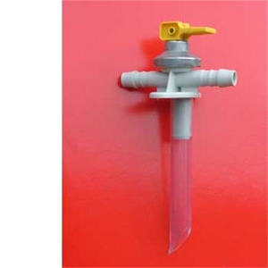

Through the floor close to the water heater there should be a toggle lever (usually yellow)
This is a drain valve combined with a pressure relief valve. It This is designed to allow the water heater to be drained the for storage, by lifting the toggle. Make sure the toggle is down for normal use.

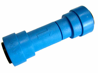

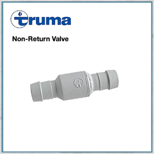

The second possible means of it leaking with no visible water loss is through the non return valves which may look like these:-
There is often two NRV's fitted to caravans systems, the first will be related to the pump, and might be fitted in cold water inlet fitted in the side wall of the caravan. and a second one fitted into the cold water inlet pipe to the heater just before the drain valve (mentioned above). These are put in place to allow water to pass in one direction only. but if they have been damaged they may not work as intended, and allow water to drain back to the cold water storage tank.
I suggest you fill the hot water tank as you have been doing. Then check the water level in the cold tank. Turn the pump off and specifically in your case open the shower tap. Wait for a while and see if the cold tank is refilling. If it is then all the NRV;s you have in the system need to be changed.
This could also explain low flow rates to the taps. One failure mode for the NRV's is if they have not been fully drained, and they subsequently freeze. The expansion of the water as it freezes can displace or permanently damage the seals inside the NRV's which prevents them from sealing and they can also reduce the flow through the valve in normal operation.
