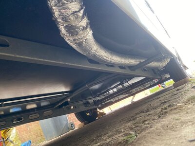

Some caravan designs are awful when it comes to the blown air system. When we had an oil filled radiator as supplementary heating it was in a 2014 Swift Challenger 586, with bunk beds and a dinette at the rear for our daughter. The blown air pipe run to the rear was so inefficient that the air emitted up there was luke warm at best and no amount of butterfly valve adjusting made much difference. Our current caravan also has the ducting for the rear air vent running underneath the caravan but I have just insulated it to hopefully improve warmth in the end bathroom.

Yes, we tried that as someone on the old Swift-talk forum suggested doing it. It made a little bit of improvement but not much. One cold day I put the heating on for half an hour and the external ducting under the caravan was warm to the touch so even though it was double skinned some of the heat loss was considerable hence fitting insulation on any caravan we have had since.

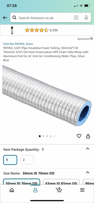

What do you use as insulation? I have a section 1-2 metres long under the caravan. It's not really an issue heating wise as its only a small 2 berth caravan, but I'd rather conserve energy than waste it.
I used one of those insulated camping mats cut into strips and tied on using cable ties.
This stuff but the 75mm ID version, got it on Amazon. For the bends I use foil bubble wrap.
