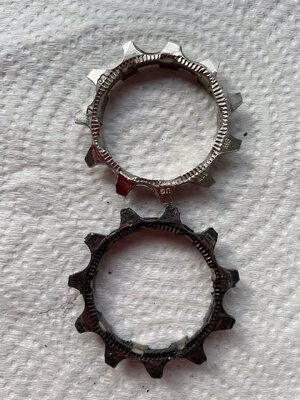

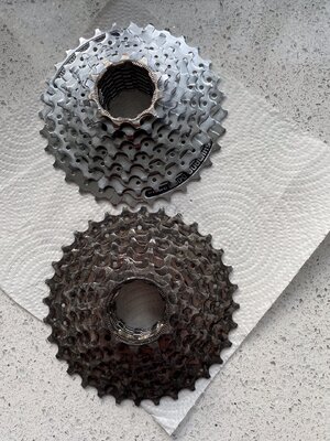

My faithful EV converted Mountain Bike
Recently poor gear change and chain jumping in 7 th and 8th.
Easy fix I said. New chain Specifically for EV s and new 8 cog gear cluster.
Took me an hour to break the old chain. I forgot the easy fastening links need to be squeezed a bit to release.
Old gear cluster was “welded “ onto the shaft. Took a Herculean effort to undue, fell on floor😥.
Shimano Deraileur was mucky . Cleaned it up to find the “indexing” adjustment screw was loose and out side the thread. No amount of Coercion would get the thread restarted. I could recut the thread but couldn’t find a tap small enough. New unit on order. Arrives Monday £18.00.
That was the end of my afternoon. Not happy.
Rant over😎

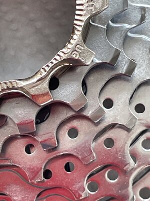

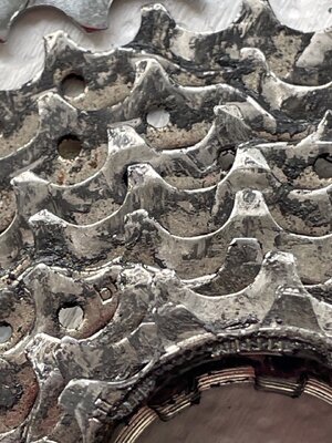

That clogged and dirty gear cluster; needs a bit more regular attention.
Jul 12, 2023
93
39
85
Your cassette looks ok to me... I've seen way worse! Be aware that poor shifting at one end or the other (but not all gears) is often the sign of a bent derailleur hanger and new parts might not fix it.
No 7&8 we’re well worn and beginning to go “hooked”. Clogging up was caused by too much 3 in 1 oil.

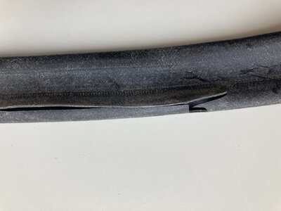

Finished granddaughter bike and started on grandsons bike. It’s never been able to hold pressure in its rear tyre since he delivered it here 12 months ago. So I thought I had better repair the puncture. Could not see any point of penetration in the tyres outer. So had no option but to remove rear wheel and extra the inner tube. Totally surprised at what I found. A long split in the tube. Clearly non repairable. Two thoughts either it had been used or walked with under inflated tyre or it had been pressurised above its 80 psi max pressure. Could also have been a defect in the tube.. Tend to favour the latter option.
So a twenty minute puncture repair then servicing the bike now has a much extended timeframe that wasn’t discussed with Mrs OC at Plan of the Day meeting. To add insult to injury the cars TPMS is showing Amber warning. But that can wait until tomorrow 🙁
