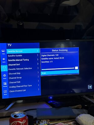

I’m doing a scan right now and it’s connected directly from the Sat to the Sat In on the back of the TV, next test will be through the Sat in at the battery box.
We’re at 47% and currently have 429 channels searched, wonder if these will all be foreign 😂
Hmm
Presume now we just go through all the 782 channels and make favourites, this is going to take ages 😂 Lots of duplicates also

Ok this is a turn up for the books.
Connected the Sat dish directly up to the TV and was able to scan many, many channels,
Then I tried connecting the same Sat black cable which came with the Sat to the battery box inlet, then using the white coaxial cable from the coaxial in using a converter to Coaxial-in and for No Signal on TV
Then I used the same cable to the Sat-in and same No Signal on TV

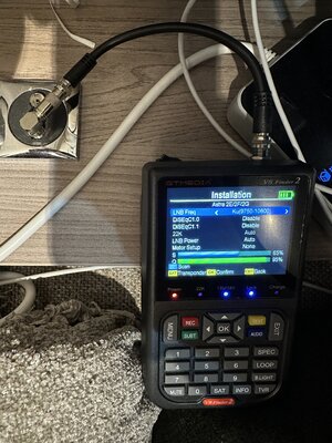

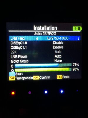

I then used my V8 finder and connected to the Sat output inside the caravan and getting 95% green quality signal, so it’s the cable I’m using does not allow a SAT signal on it, presume I’ll need to buy actual sat cable, not coaxial.

Last night I also tested the Sat-In input with the V8 finder and signal was coming through with quality 95% as pictured above.
