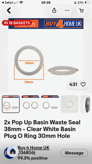

Hi the rubber washer on my Elddis avanti 840 has perished I was wondering if any one new the washer size and were to get one or have I got to change the whole thing thanks in advance
Not quite. Click-clack plugs are not quite what they seem. The washer is not just as simple round thing but rather a ring with a 'skirt' and as such are not replaceable. The only option with this type (for example as used by Bailey) is a replacement bowl drain assembly which the last time I looked cost around £20 and are beggars to fit!
