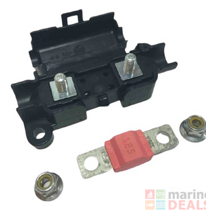

Good point and well made! I don't have one either (after only 8 years) so, having found a picture: -

I searched the Farnell website for 'Fuse, Automotive 125 A' and came up with these. Not definitive so, a call to Powrtouch will be necessary.

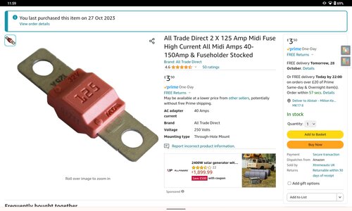

Someone on The CAndMC forum said they bought some from Amazon , but didn't state the link.

Hutch,
Many thanks for that link I'll park that until I've got another £21.50s worth of orders.:)
Oddly enough the image I found came from an Australian website; strange that there's nothing in this country.

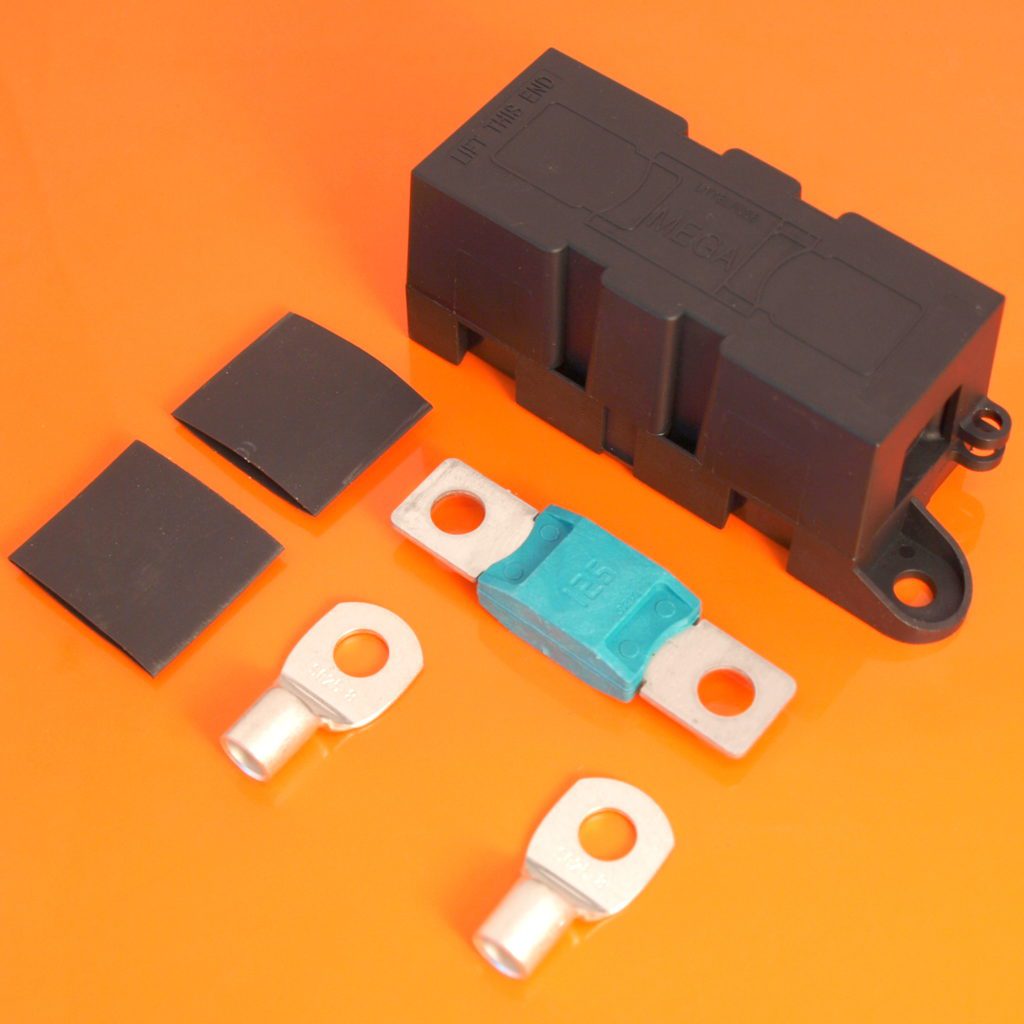

Fuse and holder for under £6 plus p&p.
Quite a few on line by searching for 125 amp in-line fuse and holder.
Thanks John, it is just the sheer lack of the actual Powertouch fuse being available, even from caravan spares suppliers.
