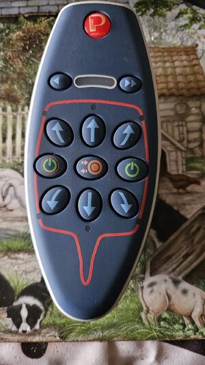

Weird, going by the instruction manual the remote I have is for actuating the rollers and the box has the extra bit for remote actuation

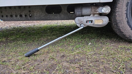

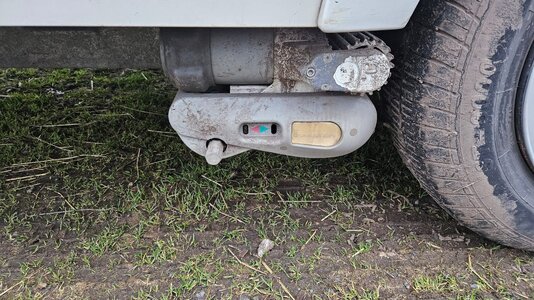

Here is my mover, in case it helps.

Now to my second question. When I press the arrow pointing forwards, above the middle button, my caravan goes backwards. Is this correct?
It seems counter intuitive to me. I think it should go forwards.
I'm bad enough at guessing which buttons to press to go the correct way. I cannot fly a drone or drive a remote control car I'm so bad.
So, is my mover wired correctly or set up properly?
Or am I going to have to man up and put it on the slowest speed and try my best :):):) and hold the remote upside down!!

Mine was a lever operated manual engagement mover. One issue I had was that unengaged the motors worked and drove the rollers. But when the rollers were engaged it kept cutting out. That’s when I discovered that there were poor connections into the motors
The lever operated don’t have a powered auto engagement but autu engagement do have a secondary mode where you can manually wind the rollers in or out if the auto powered mode isn’t working.
The red line around the buttons represents the caravan with the pointy bit (at the bottom of your picture) denoting the A Frame / hitch. When you press the bottom middle button in your picture the caravan should move in the direction the A Frame is pointing, the top middle button moves it in the opposite direction (assuming it's wired correctly).
Now I feel really stupid, it never dawned on me that the red line was a picture of the caravan.
It appears my mover doesn't have a single problem, it all works like it should, thank you all so much. Well, it does have one problem, the operator!!
:ROFLMAO:
Even knowing which button drives in which direction I still get it wrong occasionally when I walk round the caravan and turn to face the opposite direction. Try to keep the remote horizontal and orientated the same way as the caravan, and always set the speed to minimum before unhitching.
