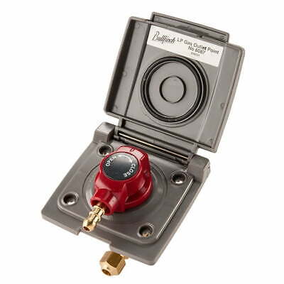

Have you thought about having a BBQ gas outlet fitted to the caravan and then fit the relevant Bayonet connectors on the gas pipes to the BBQ and Piza oven. Simple to use and no mods to the van regulator

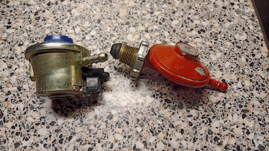

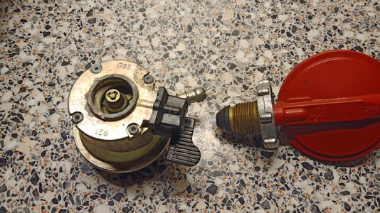

I have for my gas BBQ, (sorry Cadac, ) a quick release coupling, QR Coupling
So that I can fit either a Screw on POL pressure regulator, or a 21mm pressure regulator Calor butane . For when I use them in the garden.
The pressure regulators are fitted to the orange Flexi pipes onto the QR fittings.
I can also fit one from a QR fitting straight to the caravan BBQ out let.
27 mm reg and connector
17540820190952246071294149432796.jpg17540820504227095527900602121422.jpg27mm connector and reg.

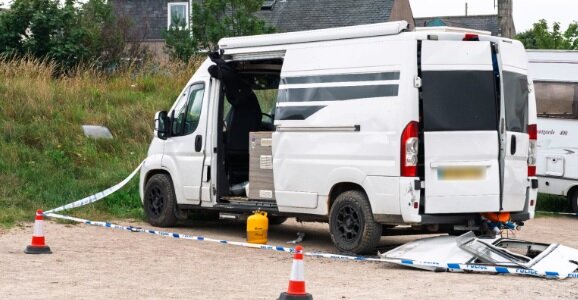

I follow with interest these conversations about adapting gas fittings.I just hope the people doing this have the equipment to fully test the system once modified for leaks and performance. The consequences can be catastrophic , this was in Lossiemouth on 14th July, the owner was airlifted to hospital.
View attachment 9388View attachment 938927mm connector and reg.
I do exactly the same as Hutch using QR couplings each with its own length of hose and regulator to fit whatever type of gas and bottle type I’m using with my CADAC. I can vary between Calor Patio gas, standard propane or CampingGaz 907 cylinder.

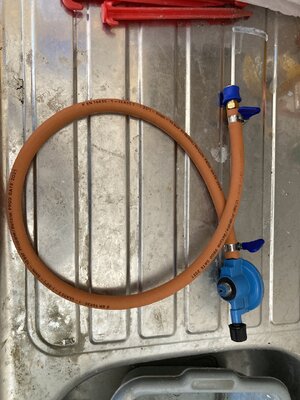

Here is a photo of my QR coupling fitted to a hose connected to a Type 794 screw in regulator for a refillable Campingaz cylinder. The kit when not in use is kept wrapped to keep buggies out.
