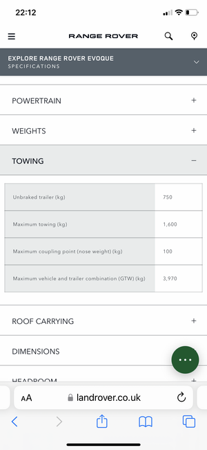

Specs, Jazzy welcome to the forum, well a quick search has come back with the specs and it seems the caravan is 18kg to heavy even totally empty for your car to tow. Your car can tow 1600 kg and the empty van is 1618 kg.

Unfortunately Jazzy, like Hutch, I have found the online information about the Buccaneer schooner 2010 and it's unladen weight before you add any of your own items is stated to be 1618Kg and based on the information you have supplied about the RR Evoque, it has a maximum towed weight of1600Kg.
I'm sorry but practically your car is not approved to tow such a heavy trailer even when empty.

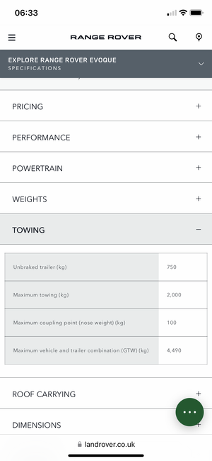

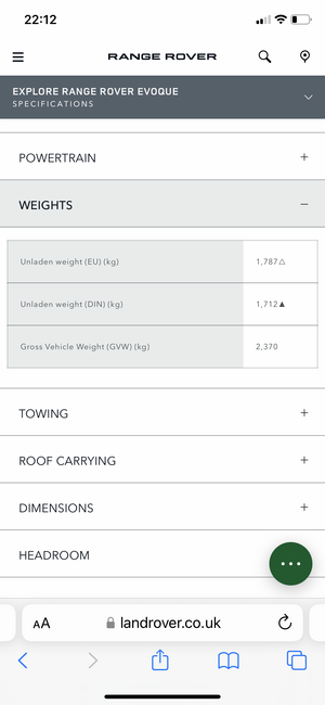

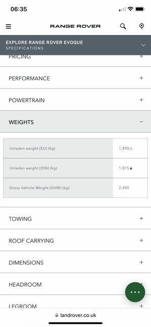

Hi. Thanks for your reply, this is the specs of my car, does this not seem ok to you to tow ? It says can tow 2000kg , thanks

The legal towing specification is the cars tally plate. That gives gross train weight, gross vehicle weight and maximum front and rear axle loadings. From those figures you get maximum towing weight. It may also be on you v5 but even on v5s errors have been reported. So you need to find the car’s weight plate.

The car's VIN plate/sticker is absolute - any other source is subject to error, particularly looking things up on the internet.
