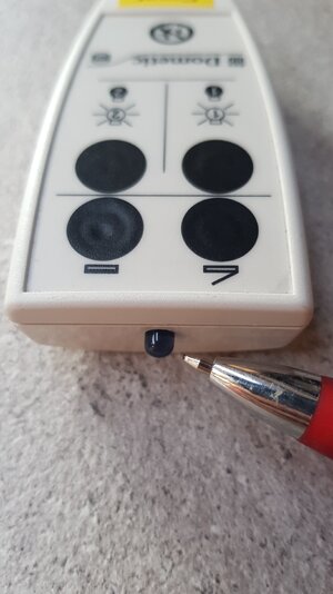

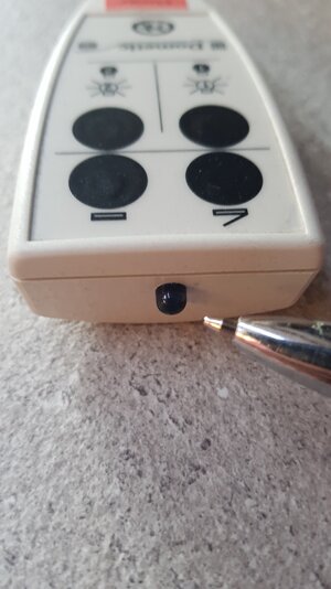

I don't normally reply on forums, but this was so encouraging. Looking into these remotes I found that the blue Bobble (red signal transmitter) was pushed into the remote casing so by un screwing the back and pushing the blue Bobble (red transmitter) meant that the red led receiver could pick it up a lot easier it was so much better Great result 😃 hope this helps. 😊17192569836775213565214305533982.jpg
