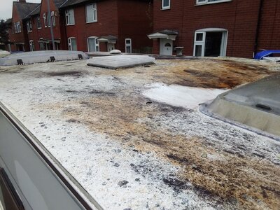

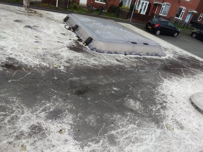

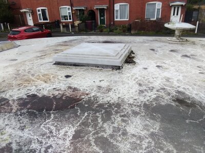

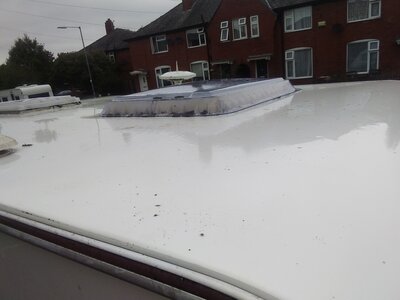

Yes but not to much effort all at once,this is the second one I've done recently,my own and my cousin's,on my own I split the roof into four separate sections on his into eight,due to the different size of roofs,this I found the easiest,I used a soft nylon sweeping brush and a light pressure after applying blaze cleaning fluid,then hosed it of,until a decent finish,,the power washer stayed in the shed.

The images are those of an Ace statesman that had been on a storage site,the a seasonal pitch,it belongs to my cousin that is partly disabled on bringing the caravan home I cleaned it for him,,

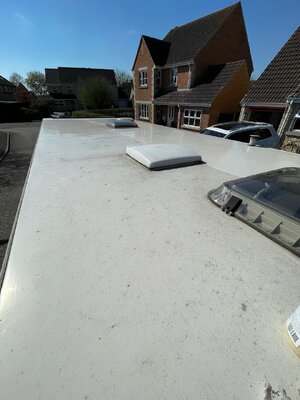

I find the hardest part of roof cleaning is the build up of lichens which need a lot of elbow grease. This year I finished off with Greased Lightning two in one cleaner and polish. Then sprayed over with Fenwicks as said by Clive and Birdman. Half done below

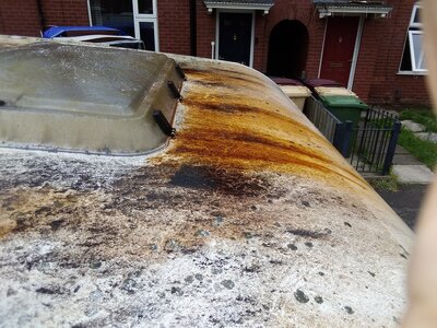

I've just been cleaning our caravan and am really struggling with the roof.
I usually use Fenwicks caravan cleaner, with a brush and it comes up fine, but not this time! I even tried a spot test with neat Fenwicks on a cloth, and that didn't make much impact.
Not wanting to use anything abrasive I used Silky cream on a patch, which works but takes a huge amount of effort.
I have added a couple of photos showing the problem and would welcome any advice/suggestions.

Strong concentration of domestic washing up liquid! It's designed/marketed to remove stubborn grease etc from saucepans and the like, so a caravan roof is well within its capabilities. Just be sure to apply a decent wax or similar once its clean as it will strip anything of that ilk that's currently on it.
