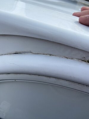

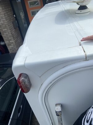

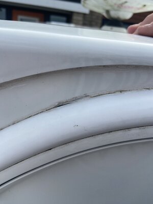

Yes, definitely had caps on already but the sealant on the awning rail beneath them looks a bit ropey so maybe this is the suspect area?
20,452
6,289
On the transverse joint that has tape on it, the tape normally is continuous across the width of the roof. About third of way across from your hand it looks as if someone has just applied sealant in a front to back direction. There’s also another odd section across the other side which appears discontinuous on the photo, but it might just be a photographic anomaly. Could you get better close ups.
Apr 25, 2021
35
18
1,535
Yeah the photo isn’t great, the tape does continue fully to the other side but there is a ‘break’ in it, so I’m going to speak to the repair guys tomorrow about that as well. Looks like there’s been a lot of patch up works done already (a little since we’ve owned the van) but not the awning rail part.
That’s very old sealant by the looks of it, is the best idea to ask them to remove existing sealant and re do it all properly?
@GaryB i think that dodgy sealant is the exact area it’s leaking.
I also think I’ve spotted what could be the issue for the front damp. The sealant looks very old on the screw panel which is holding the front locker door on the hinge. Wouldn’t be surprised if that’s been letting water in for a while and it’s been getting into the front wood shelf which is directly where that is on the inside. The window seals in that area look fine.
