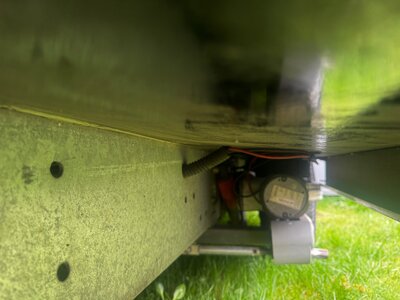

I own a 2015 Elddis Avante 576 and the left hand side of the caravan has dropped 20-30mm only from the A frame to the side its bent the floor. This has caused other issues but I was wondering if anyone has ever fixed this problem.
Its only really from the front of the van to the wheel its worse by the suspension which only has 300mm from the large frame.

The floor and the side are still intact just lower and the internals look a miss all the fixings and doors don’t line up or open. The steady’s holes don’t line up with the bolts.
The front corner is not as bad as the side of course with this side dropping the other side has gone up, the roof light is leaking water. I’ve changed the axel twice and helped for a bit until in time it gets worse. I replaced the plastic mud guard and noticed the corner was way out.
