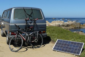

Hi everyone, hope all are well.
So appears my 97 Elddis Alfresco doesn't have a charging unit. I assume it's previous owner removed it for some unknown reason.
So my question...
If I purchase this - https://smile.amazon.co.uk/dp/B016OP9WBC/ref=cm_sw_r_cp_apa_i_lJnnFbN9PN05C
Do I simply use croc clips from the unit and that will charge the battery when the panels are out?
Then my other part to this question is I have a 12v/230v cooler box. If I am not on electrical hookup, had the panels connected to the battery, could I then use one of these
https://www.ebay.co.uk/itm/353160948662 connected to the battery to keep the box cool but also the battery carry on being charged from the panels...
I guess I'm worried the cooler box will try and take power direct from the panels if that is possible?
Thanks for your time.

Whilst a very qualified "yes" to both questions it should be noted that a 10 Watt solar panel is way too low a power rating to be of any constructive use.
We need to know the power drain of that cool box to tender any worthwhile advice, but I feel a very much bigger panel is going to be required, and even that is going to be only viable through the main season where we could have plenty of sun energy to tap into.

Thanks, the link should be for the 50W one.
This is the cool box, does t give power ratings.
Would the 50W panel help keep the battery charged instead of buying and connecting a separate charger?
