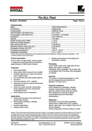

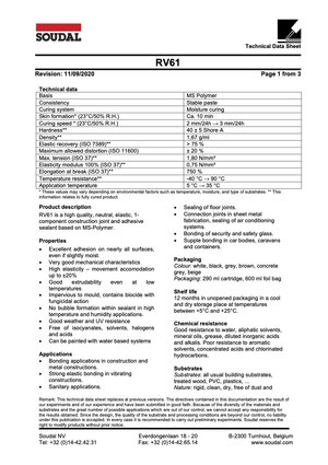

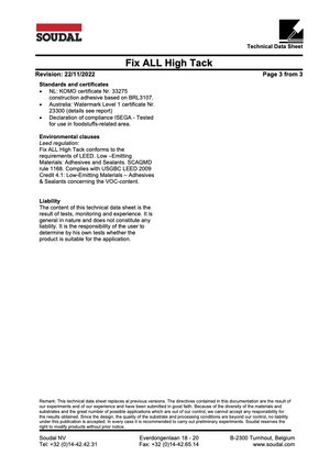

I have had a chat with Soudal technical support, perhaps it might be also useful for someone.
They recommend:
* Fix All Flexi - for windows/doors sealing
* RV61 - is an OEM adhesive sealant for bonding panels to structures i.e. GRP to GRP or painted aluminium such as awning rails and body panels
* Fix All Hight Tack - It can be used where a quick gab is required but not the first product of choice
Attaching technical data sheets for all 3
