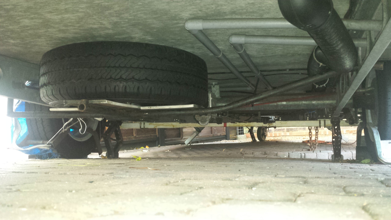

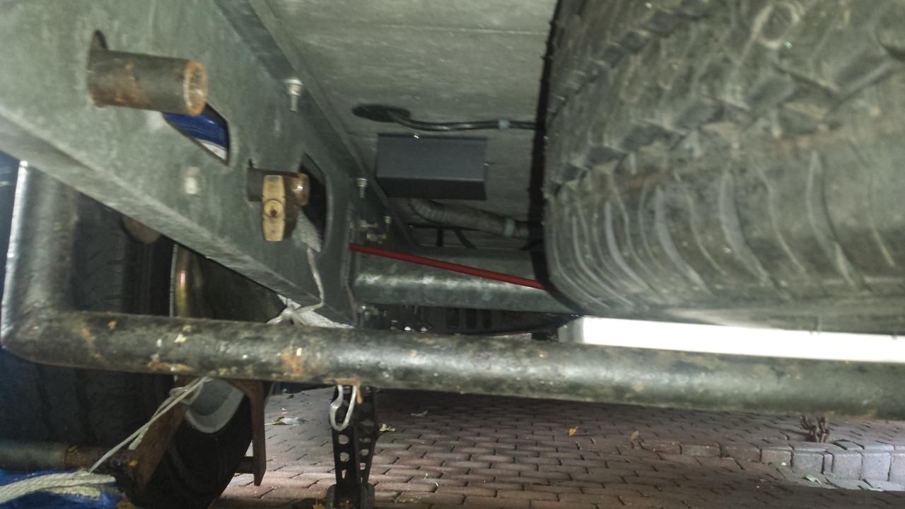

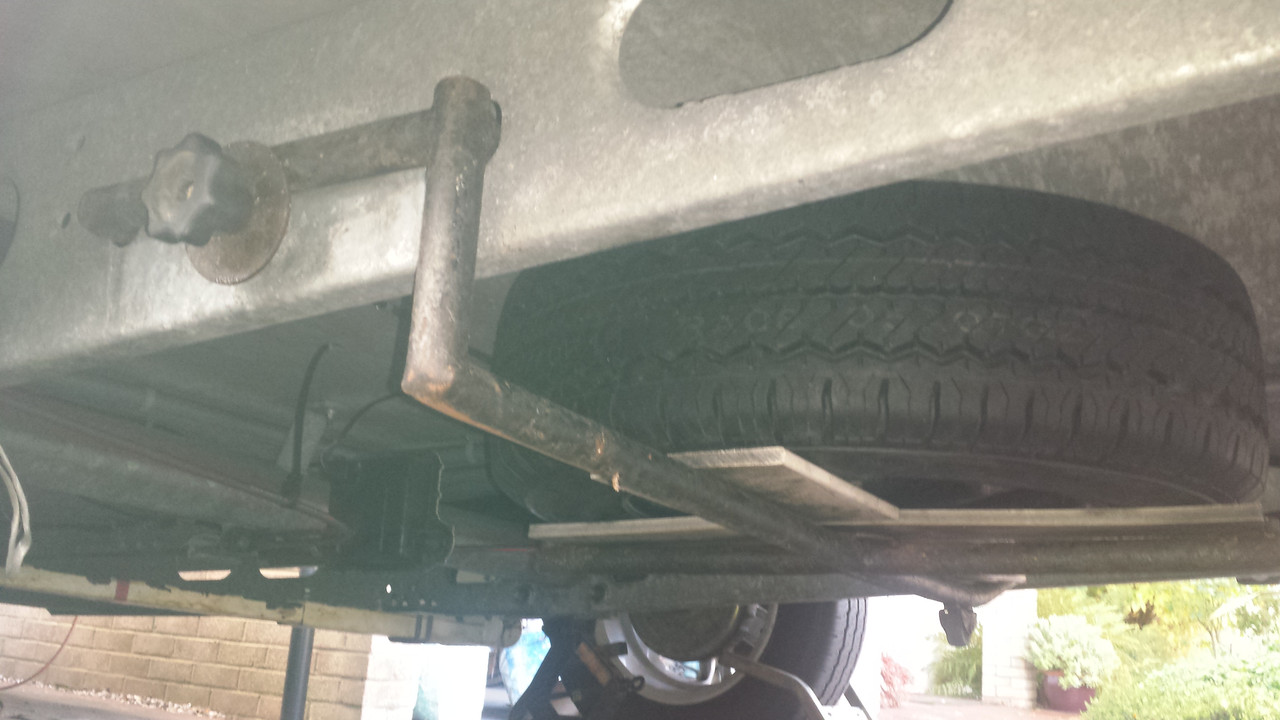

My spare wheel carrier..............
Fits in same chassis slots as the Alko carrier.
Spare wheel bolted to carrier....cannot touch anything other than carrier.
Fitted with plastic protectors to prevent vibration damage to tyre wall by carrier bars.
Locked to chassis with original Alko fixing together with padlock.
Carrier treated with wax anti rust and regularly inspected for ease of removal and continuity.
Tested for over 80,000 miles on old caravan with no isues.

Thanks Bill
You’ve had your “thinkin’-‘ed” on for that one.
I like the ground anchors too!
