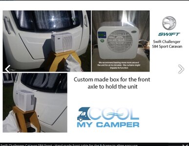

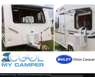

I don’t think it will be too heavy but the outside unit may be tipping backwards at the angle of the caravan front, which may be detrimental. However. I do know that someone sat theirs on the ‘A’ frame. This did mean making a simple stand for it. I have seen pictures, but I cannot find them now. If I do, I will add them.

I did find a picture of that when I did a google search, and went outside to look at my A Frame, but it may be a bit small to make something like that for the height it would need to reach. It's a shame they don't give you the option of, or pre fit, longer hoses between the units.

The umbilical between the two units isnt very long so if you have a wide opening front window then you will probably still need some sort of support frame as the umbilical isnt long enough to sit the external unit on the Aframe.

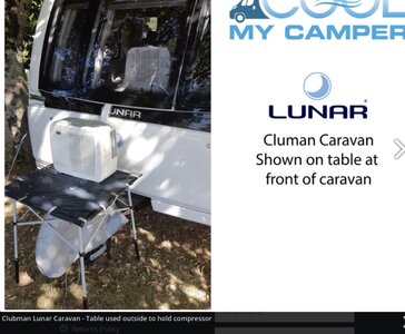

I wish I could find the picture. But from memory, the outer unit sat on a purpose made table. This may have straddled the A-frame. It gave enough height so the umbilical chord could reach.

I have little to contribute to this as I have no experience of these units. However, I did look at the Cool my Camper split unit a couple of years back and there was an option to get one with a longer umbilical in order to stand it on something solid outside.
No idea if this is an option offered by the makes you are looking at
