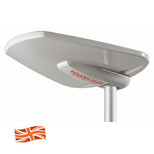

Hi all just taken delivery of 2025 Sprite - newbie. What I assume to be the TV aerial on the top of the van is not circular it has a kind of long pointy end. Does that mean I have to move it around to get a signal? (I already noticed that I could not get any radio signal on the built in radio yesterday but frankly I only looked at it for a couple of minutes so it could be user error!)
I’m sure the dealer told me the TV aerial is omni-directional which I assumed means I don’t need to move it.
The pointed end should point to the direction of the transmitter. Also when travelling put the aerial down and the pointed end facing to the rear of the caravan. On top of the amplifier there is a switch for on and off. It is not omnidirectional but needs turning to get strongest signal

It looks very similar yes - in fact I just found a leaflet in the myriad documents that the dealer gave out. It is a Status 570 Vision Plus. Looking at the leaflet I guess it is directional, and I will find some adjusters probably in a cupboard in the bedroom - will check shortly.
Also the pointed part is not pointing neither forwards or backwards even though it says int he leaflet it should do so for travelling - it’s currently pointing to about 7pm if midday is the front of the caravan. This is how the dealer gave me the caravan.

Should be a sticker near the handle, giving basic information.
To be fair the Swift aerials are quite good, slacken the large nut inside the cupboard to release it and it extends up by a couple of feet, the small plastic handle on the base allows the aerial to be tilted by about 80 degrees. If you can't get any signal check the run of the aerial coax as I have had an instance on a new caravan where the two ends hadn't been plugged together behind a cupboard!
A few points: The Status 570 will receive TV, DAB, and FM but it will NOT work with LW/MW (a.k.a. AM) as the aerial and amplifier system does not pass the lower frequency that AM uses.
The aerial itself is rather inefficient so it need a fairly powerful amplifier to make the signal usable - that is the VP3 or VP5 in the locker/cupboard where the aerial pole is to be found. The amp has a blue power LED on it (rather bright!) controlled by a rocker switch on the top edge at the left end.
The aerial is the white cable and should be connected to the appropriate amp input - on the right end. The radio and TV outlet sockets provide the same signal except that the radio socket is not amplified. If your radio signal is poor then connect the cable marked radio to one of the TV outlets.
Then you need to find the transmitter that covers the area in which you are located. Yes, by all means look where other users have pointed their aerials but you are better to look for a fixed aerial on a house or similar or even on the warden's lodge and use that as a guide. The aerial needs to be horizontal or vertical with, as already stated, the pointy end of the aerial case looking in the direction of the transmitter. Generally speaking if the aerial is horizontal you will be using a main transmitter which should give you 80 or so TV stations; if it is vertical then it is looking at a relay transmitter which in most cases will give you a maximum of about 20 stations. You have 34 radio stations in addition numbered 700-733.
