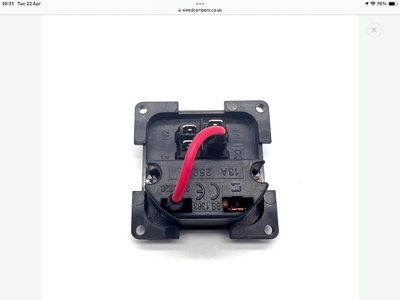

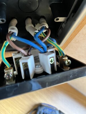

Any body changed old type spur on ultraheat to the new c-line fused spur 10 amp first photo show wire to fit on second photo many thanks

No, and please remember a standard fused/unfused switch is normally rated at 20A, the C line is only rated at 10A and the ultraheat takes about 8A so if you use the C line its life may be shorter and please if you proceed inspect it regularly. The blue wires go into N1 and N2 , the live wire ( brown) go to 1 and 2
