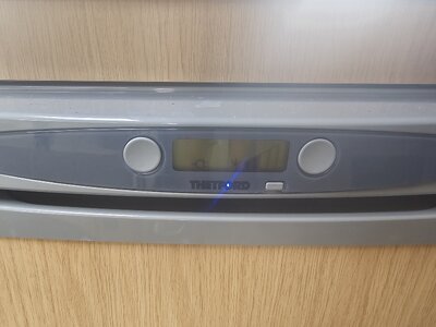

Still can not isolate the fridge.
Jul 23, 2020
124
16
4,585
So a while back, with help from here I got a solar panel.
Only issue is, I cannot get the fridge to be completely off.
So when I left the van, Master switch off, dose board off, the fridge LCD stay on showing the battery error.
I'm assuming this fridge LCD (Shown below but not in error state as I'm currently away on EHU) caused a battery drain as I left the panel out and hooked up, but when I came to move the van a week later, the battery was flat.
The next time I left it, I disconnected the battery from the van so the panel was just directly in the battery and it kept it topped up.
My worry is that I'm going away in a couple of weeks with no ehu and won't be using the fridge at all, so I don't want that draining the battery for no reason.
Can I make it so the fridge isn't drawing any power no matter how little?
Oh I tried removing the fuse in this board and it stays on.

....the small retangular button below the display is the off switch.
Hold it pushed in for 5 seconds to turn the fridge off.
Off is indicated by the blue LED.
If the blue LED stays lit then it is likely that the PCB has developed a fault and will need replacing...a common fault with these fridges.
Replacement is a plug and play DIY job taking about 30 minutes.
Cost about £80-90 for a new PCB.
Should I be able to turn it off while hooked up? I can try tomorrow when we pack up.

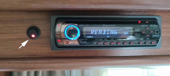

One marked Fridge Ignition/Radio showed as between 0.90 & 1.45A
This hints to me that the underlying issue might well be the radio?
If the type used in cars, these can "Hoover up" power even when ostensibly "off" if the installer did not also fit a switch in the configuration that replicates how a car's ignition switch handles the radio.
These normally have two feeds one a maintained feed of trivial consumption just enough to keep the radio's tuner selections "alive", and one that the car's ignition switches that powers the radio when it is "on". By design car radio don't have to be remotely power frugal so often are not, as there is a great big alternator to power it whilst in intended use, you are driving.
Sloopy caravan electrical equipment installers some even claiming to be professional simply supply one feed a maintained one that they split at the radio to power both, without that needed switch in the high power one. You will guess how I know they do.

Assuming it is also your issue, you might be interested in my permanent fix, using a cheap Halfords toggle switch featuring an LED that reminds us it is on power, even when the radio itself is off.
Electically, just in series with "power" feed to the radio, leaving the maintained un switched.

The radio memory is a big draw I have a switch next to the radio that disconnects power completely from the radio, it's the way forward especially as we haven't used it in a year, preferring to stream to the BT speaker we carry.
Was just chatting to father in law and saying i would add one of these. We don't use the radio but if we came to sell the van, would like it there still so this seems like the best option!
Exactly, Google home powers all our music needs!
