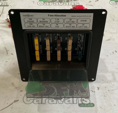

Well the hard reset worked. I removed the fuse panel and disconnected the plug at FB4 and then the backup battery at the circuit board. Leaving for a few minutes before reconnecting produced the desired results and the alarm was giving the correct bleeps. So I reassembled everything, tested and nothing. So another hard reset only this time I tested the alarm function after replacing the alarm cover and then again after screwing the fuse board back into its panel. The result was that it seems to be a dicky connection I think in the fuse panel plug. I gave it a good push and moved the harness around and now it seems to work. I know I haven’t properly cured the problem but I seem to have eliminated any problem with the alarm itself.

You have to remove the top cover. Leave the unit bolted to the floor. Disconnect power supply from the fuse panel. Plug FB4. Behind the panel. Disconnect the battery from the circuit board. Leave for ten minutes and reconnect.

This is the fuse panel that is right next to the stinger box. This panel carries the fuse for the fridge and the power from the car. At least it is on my Swift 560. Unscrew the fuse panel and on the rear bottom left you will see plug FB4. Unplugging this takes the main feed off of the Stinger. Both the Stinger and fuse panel sit under the near side settee berth. The harness from the Stinger leads into the fuse panel. You can’t mistake it. Don’t go anywhere near the main PSU.

I have a 2019 Swift Challenger 480 with the Stinger under the nearside bed and the Sargent consumer main power unit / box under the sofa on the opposite side - which you've told me not to go anywhere near (y). My only querie was the fuse panel which on your van sits next to the Stinger. IIRC on my van the Stinger is a box that stands alone and I cant remember seeing another fuse panel nearby. I'll pay a visit soon, investigate, complete the hard reset and report back. Thanks again.
