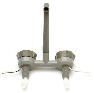

I expect you have a miscroswitch tap system. So I think you will find that the kitchen tap closes sufficiently to click off the microswitch so stops the pump running, but still leaks from the tap as you have described. So when you switch on the washroom tap the pump is switched on and then runs from the washroom and via the leak in the kitchen taps.
Your best option might be a tap replacement - about £25.00 on Ebay - but a rather fiddly job to refit - you have to access the plastic nuts on the base of the H and C taps as well as connecting the micxroswitch wiring - which may entail removing the sink to gain access. There are talk-through videos on YouTube.

OK just in case you are not sure what water system you have - pressure or microswitch, have a look under the taps - if the wires from the taps are connected = microswitch; if there are no wires or they are not connected = pressure system.

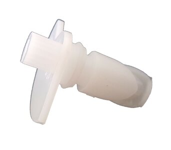

The micro switches are in the taps under the top cover/handle - see pic - these are like the ones in our kitchen area
The seal that keeps leaking is the diagonal one on the spindle , it starts to split then breaks all together. The pump is the one that came with the caravan that plugs in outside by filter.
Not sure what to do anymore as while we were away for the 4 wks. in august I changed the seals at least 3 times that I can remember. Anyone ?
