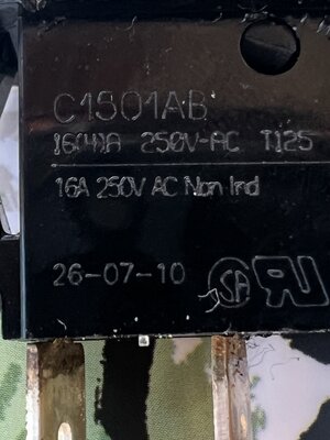

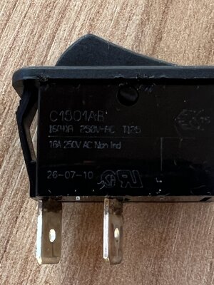

So, I removed the switch from the cooker front and it looks pretty simple in design.
Tooke the two connections off the switch and bridged them. Clicks like crazy, the way it did when we got the van July last year.
Switched the master 12 V switch off and it stops, so appears to be powered by 12V from battery.
Tap was running when I did the switch off and tap stopped too.
So needs new switch. Are these readily available.
Thanks.

I woukd imagine tge switch to be a pretty universal item, the cooker manufacturer will be buying them in.
I would try your local cooker sales outlet (not Curry's or similar) to see if they can supply a "match" ;)
5,110
2,169
11,935
You need a momentary rocker switch something like these.
Search for a ‘Momentary Rectangular Rocker Switch’
Momentary simply means you need to hold it on.
