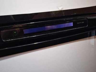

I have a Thetford N3150 Refridigrator and the LCD Display is broken. I am getting backlight on the LCD Display, but none of the Icons are indicating.
The fridge itself is working fine on 12V,230V and Gas and the buttons itself are also working.
Does anyone know which part i need to rectify the problem?

I recently had a smart thermostat which still worked but the display screen was unreadable. I found this Chinese place.
By removing the old screen ribbon connector and searching for the number printed on it, I was able to order a new one for sub £18 and a 3 week wait.
The same might work for you.
To replace the whole unit at Thetford prices will be silly money I am sure.

Thanks. The Link does not seem to work, but would sure try and purchase a new off-brand part. The annoying thing is that the fridge is fully functional , but and the screen digitizer is working (It does register pushes).
Do you also know how much the voltage on the D+ connector. (Signal Wire indicating that the car is running and the fridge running on 12V). I am setting up a 800-1000W Solar array with 4x100AH batteries and want to save gas. (Getting Gas in different countries doesnt always seem so easy as there are a myriad of connectors)

I agree with Jcloughie, take it apart and try and find a part number. THen google the part for a supplier.
I recently did this for our Whale iVan control panel. £400 for a replacement from Whale, or a screen for £70 from China (probably the original manufacturer)
Ali Express can be a bit hit and miss with quality I have found, but usually OK, delivery times can be from days to months, so be careful of that if you need it in a rush.
Happy fixing
