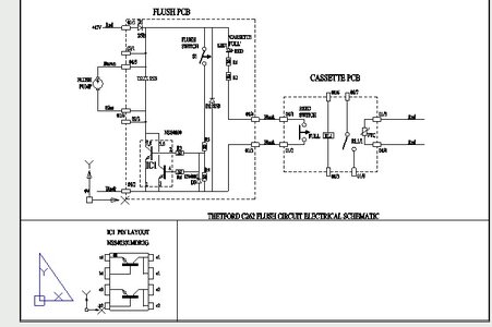

Cables tend to rot in the toilet , so given you have changed the main components ,what's left is the cables.The attached schematic is for a C260 series, the difference is minor in that the reed pcb is more simple in that it only contains the reed switch , and not the polyfuse and relay.
Thanks IanB
Not very good with wiring diagrams!
I’ve had the pump out and checked connections and wired a 9v to the cable ends and it works.
All fuses good.
Only thing I can think of is a broken control wire, but how to find which one ?

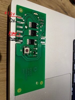

Difficult to tell on the PCB connector
Not really to test the wires to the pcb , (see attached photo, the) 12V supply and return come to the pcb on the first two pins( 1& 2) and the pump supply and return go out on pins 5 & 6. With everything connected up , with your DMM put the probes on 1 & 2 ,(there is enough of the contact pad to touch the DMM probes to even with the edge connector connected) you should see 12V ,
then press press the flush button , if the voltage disappears then its the supply cables, simply replace with new , they run down the back of the flush tank into the cassette locker where there will be a fuse and some connections back to the main fuse board pcb somewhere near the front of the caravan. Disconnect the battery and cut off the pcb edge connector , leaving about 25 mm of wire , then feed the new wires down the back of the flush tank to where the fuse is and connect up the existing supply wires ( which also can be cut back ) when making the new joints cover with heat shrink tubing (3mm) to seal the joints against moisture. You also just buy a new wiring harness if not confident to solder the wires together.
