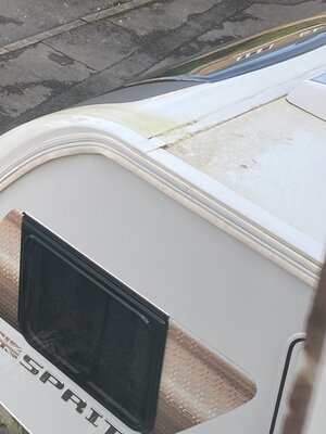

Unfortunately some (like ours) have a raised area around the sides as well so no matter which way you tilt it, some pooling is inevitable. I took this photo just now. I suppose this is where a cover would be a big help.
I would be seriously thinking about getting that roof resealed.
My Coachman was totally resealed by Coachman when it went back for a rear panel at 3 years old. Although everything looks good now at 10 years. I have been thinking for many year to cover all seals with roof lock tape.

The seals are fine, yes they look awful and here’s why. The mouldings used by Swift are cosmetic, they cover (hide?) the actual mastic water seal beneath, they are plastic and are manufactured with a protective clear film on top that SHOULD be peeled off when fitted and BEFORE the edges are cosmetically sealed with sealant. But the protective film was left in place and is now starting to peel away itself thus looking awful. Still 100% water tight but visually challenged.
The caravan goes back to Swift on 4th December for a new side and I have been promised that all seals will be tidied on the roof and that the blobs and smears of sealant on it left by a clumsy worker will be sorted.
We’ll see……
We’ll see……
Hopefully all will be well, but a cosmetic strap should be, properly sealed. That picture you show is not sealed properly and will be the start of a water leak.
Hopefully your dealer will sort it out.
