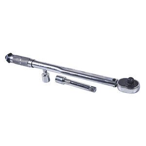

Then there is that well known online auction site, has many on offer,
eg LINK. Even comes with a 19mm socket, the preferred 6 cornered type.
How accurate, is anybody's guess but actually checking, using water and tape measure is easy if you have a strong enough bench mounted vice.
[An apprentice tool maker exercise back in the fifties, make and calibrate a bendy bar torque wrench]
However, I would wager that out of the box it will still be nearer "right" and consistent than your adviser in Halfords would be likely to be.
eg LINK.
How accurate is anybody's guess but actually checking, using water and tape measure is easy if you have a strong enough bench mounted vice.
However, I would wager that out of the box it will still be nearer "right" than your adviser in Halfords would be likely to be.
That wrench, is looking the same as the Lidl, Parkside branded torque wrench, Austrian made.
