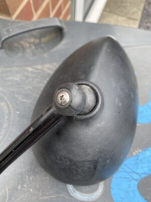

I cannot explain how I did it as it has been a few years since I had the issue, but I remember altering the top of the clamp which holds the bar so the one nearest the window was to the rear of the car and the outside one towards the front. So that the bar was no longer parrellel to the car mirror. In this way, when the car mirrors closed, the towing mirrors were held away.
I have now sorted the "hitting the door glass" issue. In the end I removed the mirror knuckle joint from the arm extension and re-drilled it's hole a few degrees further round, this enabled the cranked part of the arm to face further forwards, thus putting the mirror a bit further forward and (just!) misses the door glass now.
