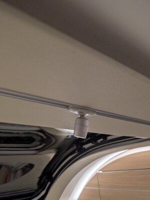

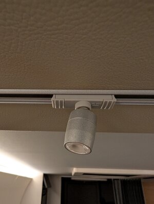

I have these lights in my 2023 Adria van. There are a couple of runs / tracks, one in the front of the van and one in the back. They both have 3 of the spot lights on that can slide across the track to position where you want.
Does anyone know how to replace a light or check the wiring? One of the tracks seems generally temperamental, lights flicker and sometimes work, sometimes don't, and on another track one of the bulbs has stopped.
I can't see how to get to the lights and wiring to take a look. There is a couple of screws that I assume hold the light track up so could unscrew them but before I start taking things apart I wondered if anyone has experience of these and if perhaps there was a way of removing the lights individually themselves?
Also, searched the web and can't actually a replacement track if that is what needed. Does anyone know what light make Adria use?

I think the ends slide out of the LED part, you can clearly see an arrow on the pic
If you look closely at the middle photo, that shows the wording, lock, unlock, probably for moving position. Maybe the end caps at the end of the rail can be removed and the light slides out.

That’s what I was looking at, but it’s the end of the light part, not the rail 🤔

Update on this, lights just pull out ! That helps, I am assuming that the screws are to remove / replace the physical track.
The lock / unlock is as above, push in to lock lights in place, unlock to slide along.
