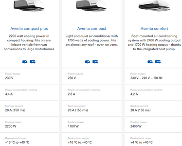

I'm pretty sure it's the Truma Aventa Compact Plus A/C which is being fitted, although could be wrong, if anyone wants to correct me?

How would we know what you have ordered when there are three options shown. Surely you know what you have ordered.

I honestly thought I wrote what model it was, how very strange....
It should be the Aventa Compact Plus

Looking at the specs there is a very significant, but short, start up amperage well over 20 amps and that might cause the supply bollard to trip out if its sensitive.,

Buckman has AC on his caravan and it doesn’t trip the EHU supplies as it kicks in. He’s had a previous one too, so as you say the maker has done their homework. The OPs post above showing the three aircon models gives overcurrent durations.
