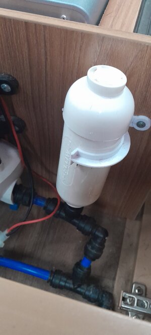

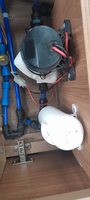

On last years caravan service it states - requires a new truma filter cartridge, there is only a single filler connection outdide the van, and this alongside the pump, is this the filter housing?

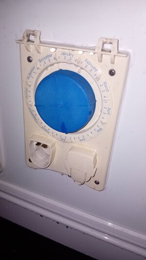

Hi , the filter housing is outside the van . Whenever you lift the white flap door you'll see a blue cap . Unscrew this and it it will come out with a black cylindrical charcoal filter. A replacement can be purchased on eBay.

Most vans have what I photographed. The photos you put up are not filters . Don't panic though. Someone else here will come along and help . Probably they're just having their tea at the moment. In the meantime, look up truma filters online and you'll see .

The white object in the OP's pictures is the surge damper.
If you don't have the blue capped compartment in Richard Avensis's picture you need to find somewhere else to get your caravan serviced as they're giving you BS.

As per Roger that is the surge damper. As per Richard Avensis we had the same water connection on our Lunar and had it exchanged for the newer Truma connection which does not have the "built in" filter. We did not have a filter fitted for the caravan in all the time we had it.
