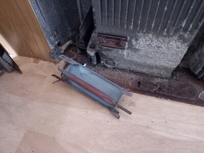

I cant get my Trumatic S3002P gas heater to work - we have gas and power but no spark (although it makes a noise) and no smell of gas when I push and turn the dial.. the sparker unit seems to have lost its attachment,,, see pics.. any ideas?

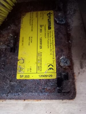

Have you had it working previously? Looking at its poor condition it could benefit from a total overhaul service as the labels could indicate it’s over 20 years old. I’d be concerned at areas that cannot be seen in the photos.
At 20 years old and the apparent lack of attention and poor condition I’d have it sorted professionally. Have you recently acquired the caravan? I ask as you seem to think parts may be missing? Have you had the heater working on gas ever?
I am particularly concerned by the amount of corrosion evident at the bottom e of the heat exchanger and floor plate, and it has the appearance of having been stood in water. Has the caravan been flooded?

Hi l think we would all agree the heater is scrap and as ProfJohn has already said it could of been flooded so I would check units, floor and bottom of the walls for any delamination / discolouration. However looking at the photos it would seem that the combustion chamber of the heater is full of rust/debris which would indicate to me that the cowl / rain deflector on top of the flu is or has been missing for a long time.

I'm not sure how you have come to that conclusion, as all you can see the mica window, you cant see inside the combustion chamber. However it is fair bet that with such extensive corrosion of both the floor plate and the outside of the heat exchanger, there is a a high probability the internal parts (Burner Bar and its supports, spark electrode and the gas injectors will also be similarly degraded and non operational.
