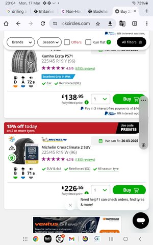

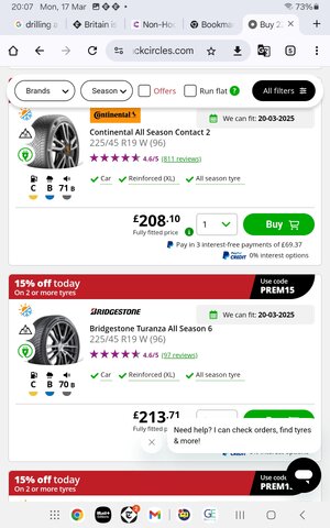

Often the mid range tyres have BETTER wet grip than premium ones. See below for Kuhmo V Michelin. I accept that the Michelin have better economy, but it proves my point doesn't it??
Then look at the wet grip for far more expensive "premium" tyres tgat cost £100 more. Doesn't make sense does it?

I cannot see that your post does prove your point. You have shown a summer tyre versus three all seasons, so it does not make sense does it? Not a valid comparison. The wet rating comparison doesn’t say how close the all seasons came to earning an A rating. A shortcoming in the grading system. For all I know the other three tyres might be be verging in the A rating.
I look at tyre test reviews that test the tyres not in a laboratory but in real world conditions for cold, wet, dry and temperate.

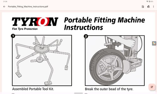

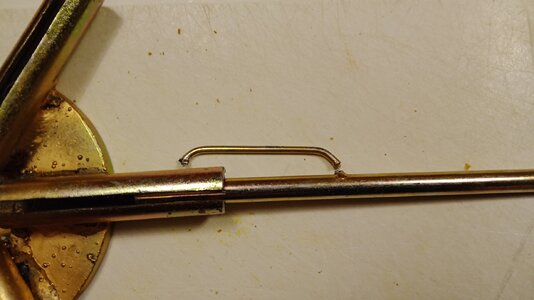

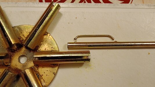

Hi Bob , you are the only other person that I have known to have the Tyron band kit, in my case the aligning piece snapped off all six arms. Just not strong enough.
Had I found the kit strong enough I would have refitted the bands. The last time I changed tyres previous to having the kit, it was a real Pain.
My wheels are Alloy and the beads are extremely tight, I would think (without bands) with a normal puncture the tyre would stay in place, but with steel wheels I would think maybe the tyre without the band might slip into the much larger well and come off. But that is just my opinion.
The photo shows the aligning bit snapped off from the spider leg.

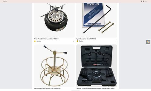

Just checked on Tyron bands and it seems like there are at least 4 different Tyron Band portable kits. TR3030, TR 3040. And at least two others.
A 4 legged one, and three 6 legged ones, mine WAS the flimsy 6 legged one, as in the lower diagram.

Thanks Hutch. My kit is a 4-leg kit and quite robust. However, I suspect that I probably don't need the bands anymore. Will talk to the fitters who can check my wheels.
At least the four legged one looks robust , mine as you wound the spider down it tended to turn clockwise and sheared off those little guides. That was after the beads had been broken as well. The feet also dug into the tyre walls, not happy with that.
