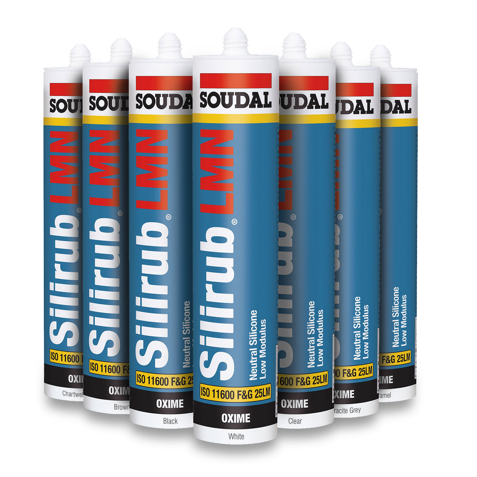

Thank you Damian, I have added them to my Amazon basket. Do you know what soudall Fixall I should be using? I was also recommended Sikaflex?

The type you want is a low modulus sealer as here
You could also use Sikaflex 512 but I have found that Soudall is much easier to work with and tools well to give a neater finish.
