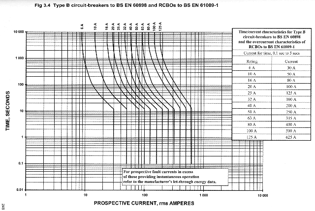

Technically watts = Volt x Amps x Power factor correction and with a heater the power factor is 1 so for real life we can consider that VA = Watts.
Now our systems are normally limited by miniature circuit breakers (MCB) which is two devices in one, so a B16 MCB will trip at between 3 and 5 times the rated current using the magnetic part of the trip, and this will happen in around 0.01 seconds. However the thermal part of the trip takes a lot longer, there are charts, but at 16A it should never trip and at 20A it will likely take at least 1/2 an hour, so if you have a thermostat switching off/on every 15 minutes then the MCB is looking at the average current rather than spot current.
So with a room heated set to 2000W (8.7 amp) it will normally take same average current as set to 500W (2.2 amp) once caravan is up to temperature. Where the problem lies is a kettle, water heater, room heater and battery charger all being switched on together so 2.7kW + 2KW + 0.75KW + 0.25kW all together = 5.7kW or 25A which will not reduce fast enough to stop the MCB tripping,
you have around 1000 seconds or 16 minutes and your just on the edge as to if kettle knocks off or the MCB trips first.
If the MCB is already warm it will take less time, so using the room heater at 500W means it is less likely to trip before the kettle boils at 18.3 amp it is still over 16A but time is more like 10,000 seconds or just under 3 hours, so kettle will have boiled and knocked off well before then.
Whole idea of MCB thermal part is to stop cables melting, so cables also take time to heat up, so as long as the MCB trips before cable melts there is no problem.
