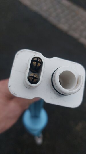

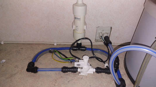

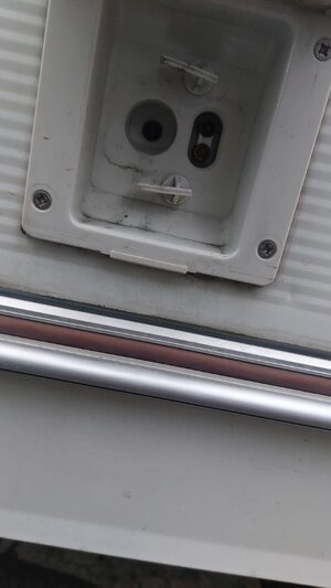

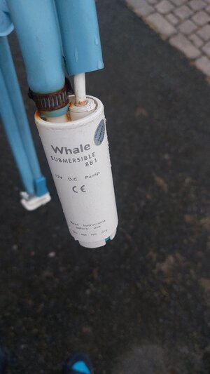

I've attached a couple of photos of the pump/water system of the van (I hope they might be of use in the process of elimination).
I'm not sure what the impeller is, sorry. I can't see anything on the pump that I'd be able to turn.

On the end of the pump there is normally a small hole where a small flat blades screw driver can be inserted to turn the impeller. On some pumps there is a blue "mesh" cover that can be removed.

You have a Truma Crystal system for the pump connection to the caravan, (pic 4) but the fact you have a whale pump and a jubilee clip to retain the hose onto the pump shows this is not the original pump. That is not a problem, but it just shows it has been changed at some point in its history.
You need to check if power is reaching the pump, and the way to do it is to unplug the hose from the caravan, and using a multimeter check to see if you have between 11.5 and 13.8Vdc on the brass female terminals in the side of the caravan when you turn the 12V pump switch on.
If you find the voltage at he wall, then it suggests the pump may be faulty. Try the idea that Hutch has suggested, which might get the pump working, but it might not if the pump has failed.
The pump is controlled by an adjustable Whale pressure switch shown in your 5th picture . See here for setting instructions

Looking at the colour of the connectors I would probably guess the ones on the caravan are the same, give them a good clean, try the pump again, if it doesn’t work then check for 12v at the pump inlet as prof said

A common issue was the connector prongs or pins on the pump itself where it plugs into the side of the caravan. These get dirty or loose over time and the connection is poor. The end result is that it then arcs on the connection causing the fuse to blow. You need to give the pins a good clean with sandpaper and make sure that the connection is good and tight. Whale pumps seldom fail.
