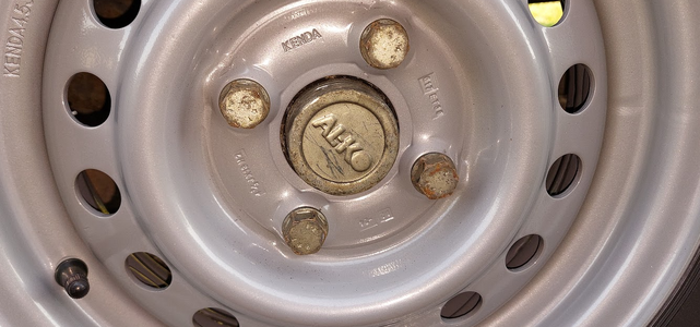

Hi everyone,
I’m looking for some advice and hope you can help.
I recently bought new wheels for my 1998 Swift Caravan. When I went to fit them, I noticed that the dust cap in the center of the old wheels is around 55mm, while the new wheels have a 60mm center. Is this an issue? The bolts are cone-shaped and seem to locate the wheels well, and the dust cap is only made of aluminum.
Thanks in advance for your help!

Is this a different size dust cap? If so, it simply will not fit onto the hub. Or are you saying that the hole in the rim is larger. If so, that will not be a problem.

The dust caps are the original ones, more than likely been on the caravan since it was built in '98. I see that 55mm AL-KO is a common size grease/dust cap. but no one seems to supply wheels with a 55mm hole. The new wheels have a 60mm hole.

The dust cap seals the wheel bearings grease in (it has Alko stamped in it) its a firm push fit into the hub so as long as the wheel fits over it OK there's no issue at all.

The dust cap plays and must not play any part in centering the wheel.
From what you stated I am assuming the wheel having a 60 mm dia hole fits over the 55mm dia cap with the needed clearance all round it? If so on that point it is correct.
Your mention of the bolts being "cone shaped", this really needs rechecking as more typically steel wheels use "spherical" profiled bolts and seatings, not cones.
Cone shaped bolts would very commonly be used on alloy wheels.
You are advised to recheck the wheel's bolt seating shape, to ensure it is not spherical, if it is for safety you must use the correct shaped spherical bolts, doing otherwise is dangerous.

Thanks for all the messages. When I re-measured the original wheels the centre hole was indeed 60mm, so there was a 2.5mm gap between the wheel and the dust cap, which I had previously failed to notice.
As for the wheel bolts, the mounting face is definitely conical, not spherical, both the old and the new wheels are the same, so it looks like I'm good to go!
