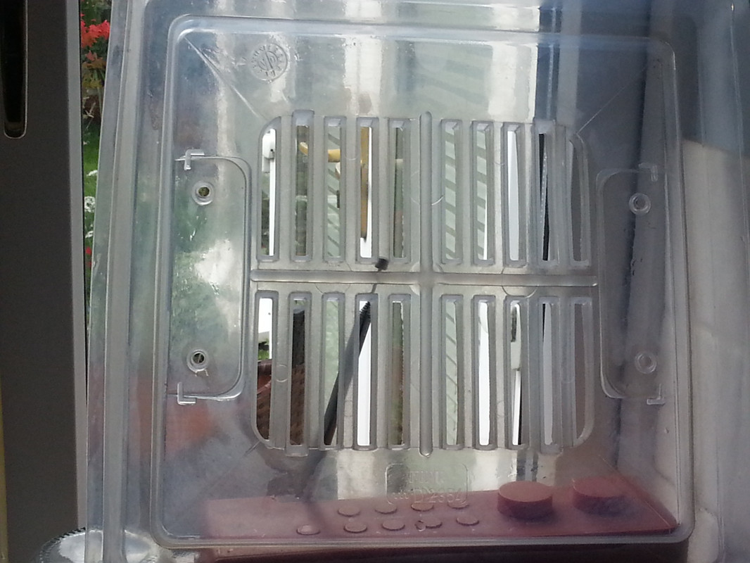

Here’s part of my Heki cleaned a few months ago. Mine is in two sections.
Warning :woohoo:
Only unscrew on a warm day. Do not use force.
Very slightly tighten first then undo.
The lugs are delicate, brittle and will break if forced.
On reassembly I used a smear of silicon spray.
Do NOT overtighten. Just pinch the screws.
A pipe. Cleaner or whatever won’t work.
Warning :woohoo:
