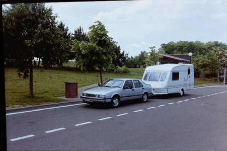

Wonder f you were one of the police motorcyclists who pulled me into a Highways Depot near Ringwood? In those days probably Dept of Transport. No infringements I’m pleased to say, despite giving car and caravan a free health check and weight check. 🤔
Quite possibly!
We did get a fair few drastically overweight cars and trailer/caravan rigs. It was really concerning to find that SO many drivers were totally unaware of any weight restrictions applicable to their cars, let alone what they were towing!,

Quite possibly!
Visually mine was a well balanced outfit. Saab 9000 towing 2 berth Elddis within speed limit. Guess it was luck of the draw. 😃
At least my spreadsheets of weights was accurate.
