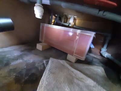

The pipes going into the heater seem to all have a "diversion" tube, which leads to an open box stored underneath the floor (pic below).
The previous owner told me the plumber who installed it said it is to accommodate overflow of the heating liquid - and indeed it seems to fill up with an orange liquid (your usual water+glycol mix I guess). The liquid filling the box is not recirculated in the system - I have to keep an eye that it does not fill up and spill on the floor...
