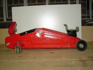

Hi John G
Brilliant. I've just bought one! Not really out until tomorow but store manager was ok letting me have one today. Smaller and lighter than my old jack.
Just given the Wyoming a lift. So so so easy and transportable.
Why can't the manufacturers like BAILEY supply one of these in the first place? I am sure they could buy them in bulk for less than a fiver.

HiJohn
great pic and mod.
I'll have a look at mine tomorrow if it's not raining. I assume any mod I make will be much the same as yours.
Are you able to let me know the dimensions ie length breadth height?

4,638
Hi alan
I will measure up later
The piece of metal I used came off a loudspeaker originally and was among some souvenirs of my dad who has been dead 22 years!!!
I made another adapter for my friend using 1/8in thick steel and a vice to bend it
He subsequently bought the Kojak but still needed the bit I made as he couldn't use the Kojak on the same side as the Alko wheel carrier
The artical in this months C & CC mag seemed to have missed the point that its not hetting the spare out when using the Kojack but using the Kojak for levelling with the Alko carrier in place(that's what we both found on the Pageant Bordeaux 5)
Basically its got an upstand that fits into the Alko bracket and the U section is just wide enough to span the chassis to avoid slipping
I fitted a big washer uderneath the bracket and inside the existing jack cup to give some sideways stability and countersunk the centre bolt which fixes with an R clip so it can be removed for using the jack on a car etc

Thanks John , I get the picture and will knock something up next week.
