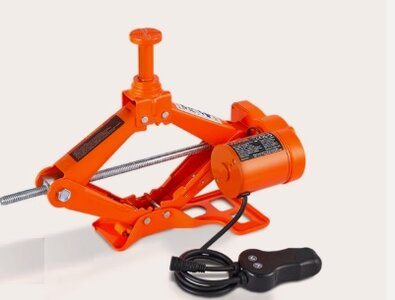

I have the kojack bottle jack and lifting points on my caravan , they don't look like they would twist and buckle, but I won't know until the caravan twists. I also have a Vevor electric scissor jack and once a caravan twisted as it was lifted and the foot of the jack was bent out of shape, I have now reinforced the foot with 3mm steel plate and also place a larger 2mm steel plate under the jack to stop it digging it on soft/uneven ground. I also chock the other wheel(s) when lifting caravans.Once lifted I don't trust jacks( particularly hydraulic ones) so also place a stack of wooden blocks (old joists ) under the axle , as a safety measure . You can never be too careful when lifting up a caravan.
