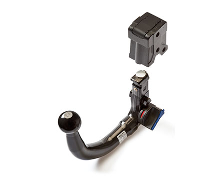

Anyone had issues with a detachable Witter Tow Ball unlocking?
Witter, like many other towbar manufactures use ACS components
I have a TT system that also uses ACS system, as I tow a caravan with an ALKO hitch (no grease) and numerous trailers that require a greased tow ball I decided that to save any chance of contaminating the ALKO pads I'd get a second swan neck, was met with the same feedback that swan necks were not sold separately to Joe public because of the potential wear issues. To cut a long story short I bought a used one off Ebay for £15, it even came with a bag & key.
Using a micrometer, I measured all the important dimensions of the used swan neck, compared to the new one and they were with the H7/h6 spec that clearance fit components demand.
I can understand in these days of litigation why firms will err on the side of caution, but with a bit of common engineering scene applied its not a problem.
If you require spare keys (and there are only 10 in the range, so not that secure especially as they key number is marked on the lock! but better than nothing and will deter the opportunist thief), don't go to a towbar firm, use a key specialist, who will provide the for half the price:

It was precisely wear caused by leaving the unloaded Brink [ later becoming Thule] detachable tow hook in Discovery 3 & 4s that reportedly lead to that design's issues. They fretted by rattling across the unloaded clearances, wearing things such that when used loaded things stared to smashed up the reciever!
It is not necessarily a bright idea to use stuff differently to what it was designed for.

I would presume they wouldn't sell separate neck parts if it wasn’t ok

At the risk of repeating myself, I mentioned in another post that TowTrust states that their detachable towbar should not be left attached to the vehicle for longer than ten days to avoid it seizing inside the receiver.
I don't know if this is the same for other manufacturers.

Cannot recall that requirement when I used Witter. It was often left on for longer than ten days when on longer holidays, then the time to get van ready for returning to storage site when we got home. But in general it was detached when I had finished with it.

On our previous Jeep we always removed the tow hitch even when on site for 2 - 3 days. Cannot recall if it was recommended, but it did save a few shins.
I have in fact left mine in place for several weeks but, never through the Winter months though when salted roads may exacerbate the risk of seizing.
I’m towing on Monday. Thereafter I’ll remove it, hopefully! Looking at the Westfalia videos the neck looks tapered so it shouldn’t be loose. WD 40 to hand for the lock!
