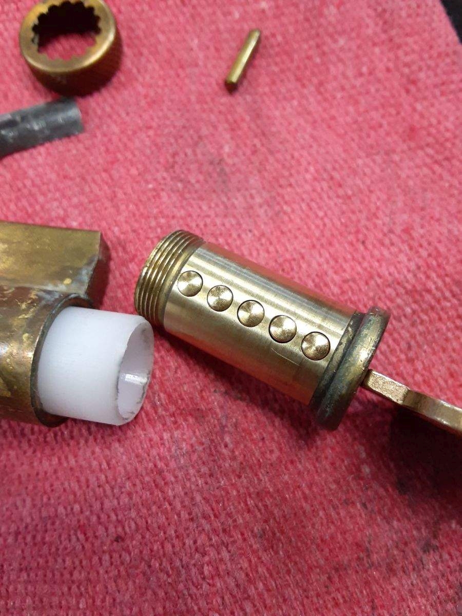

Anyone had issues with a detachable Witter Tow Ball unlocking?
We handed the car in and got it back all completed, not sure what all happened in the background
Not sure if I can clean out the lot of WD40 as its completely in the mechanism
Meths or isopropyl if you have any. But I really cannot envisage that the wd40 has caused the barrel to eject. More likely it wasn’t inserted properly.
I just googled using WD40 in a key lock and everywhere suggests not to use it 🙁
I may just leave it as is, I don’t want to try adding more chemicals which may make it worse than it already is.
The guy from the fitting place is calling me tomorrow, so I’ll have to say I sprayed some WD40 in then tried the key 10seconds after spraying. Surely that would be ok, but I just hope he doesn’t say I’ve voided the warranty….
It costs roughly £300 for a new SQ5 Swan bar on its own, I’m thinking I should have just left it, hope I’m ok
Using WD 40 on a sticky lock isn’t a deal breaker imo. Trying to apply other chemicals may be a problem.
Hope the tow bar firm resolve the issue for you, and show you how ”easy” it is to operate 😉
Whilst you wouldn’t use WD 40 regularly to lubricate locks, there are dedicated lock lubricants, but one shot to see if it helps release a stuck key isn’t going to do any harm.
I tended to use a silicon lubricant, or Teflon based like GT85. Some recommend graphite powder dry lub, but it can build up if used incorrectly and absorb moisture or oils. Whereas silicon and Teflon do not absorb or bond with contaminant.
Same issue
Same issue
That’s an Interesting thread, so you are not unique. Hopefully it can be sorted but I’d still contact Witter to discuss and advise as if your technician fits a new lock body you don’t know if the fault may be with the towball and it could crop up again.
At worst the spare part needed will be a new barrel with its keys; yours looks a standard enough item, costing typically about £10 to £20.

Ok good news folks, and absolute fantastic service from the Auto Electrics in Aberdeen.
The manager called me up and was surprised by the Email I sent this morning, which included photos of the barrel, and I also mentioned that I sprayed a little WD40 inside. He fully agreed this shouldn't have happened, and had already contacted Witter who are now sending him a full neck kit, not sure what all will be in it
He is just going to send me the kit once it arrives, then send it to my house address using parcelforce, and I can pick out the brand new Swan Neck and new keys.
Absolute brilliant service, and all the worry has gone 🙂
